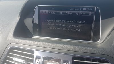

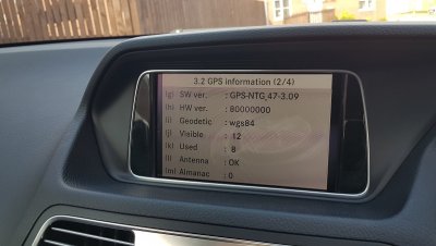

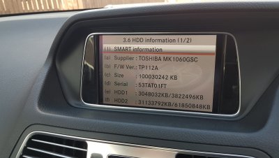

Hi I have a 2013 C207 E class coupe with Comand 4.7 which has started to error out.
Initially the sat nav wont load ( was working fine ) and has said "map data does not match comand Please insert map data DVD with the correct map material. I have tried a reset and no joy there, I have also noticed that some of the music on the hard drive has "disappeared". I suspect as its effectively a 7 year old hard drive this is likely to be the issue and that a possible solution is a replacement and reload. Where to start. The drive installed is a MK1060GSC which is I believe an automotive grade HDD which is no longer made. Ideally I dont want to ebay and get another 6 year old drive as this kind of defeats the point as HDD only last a certain time. I have read that possibly an SSD might be the solution. Any help appreciated. The comand unit has been plugged into smart and no error codes are present. Does anyone have any suggestions on next steps? Cheers

It does look like a hard drive issue. You cannot just put another drive in. They are locked to a serial number of the unit and bios protected. Replacement drive is about £600 fitted with maps etc.
Yes, the HDD is shoot, I was lucky just got mine HU replacement under warrenty, car was nearly 5 years old, mercedes design to put a HDD into its Headunit as a time bomb for maintainance trap !!!
The HU was unable to search MP3 and stuck in the "please wait" forever then freeze up and needed reboot randomly.
