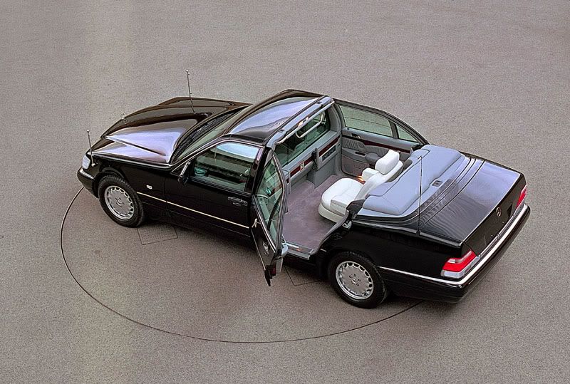

Recently I had a look at a CL600 up for sale for a friend.Perhaps the most
amount of car I've ever seen for £5k.The V8's are a little bit common for my
taste,the Pope uses one, almost sluming it...V12's are the way to go.

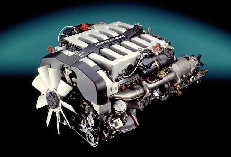

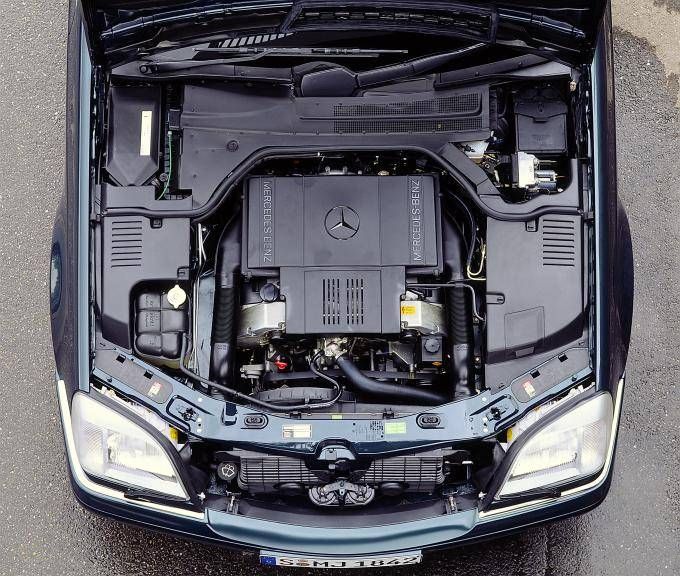

V8 Coupe
V12
