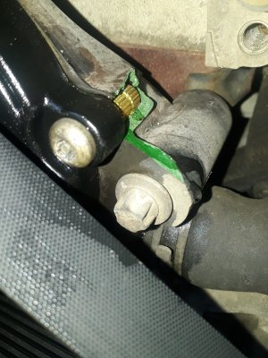

sorry for the late reply, the culprit was the water pump housing, the housing which the pump attaches to was cracked at the back, i have now replaced both pump and housing and fingers crossed no leaks as of yet.

i originally went to a garage with this problem while the car was under warranty, they advised it could be the EGR cooler, i inspected the EGR cooler and while i was at it i inspected the fuel filter housing, both of which was working as they should, i thought how could a garage miss this kind of damage. now the car is out of warranty i have had to fork the bill out myself
