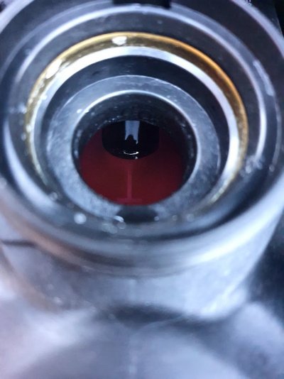

Hey all. I've got a Jan 2020 C300 Coupe, and tonight I got a yellow coolant warning on the digital dash. Let the car cool and took the cap off the expansion tank. There's definitely coolant in there, but I'm not sure I'm reading the level right. The lower part of the tank is white, the top is black. In the lower part is two raised lines that form a T-shape. I think that is the level guide? It's above that, but it might not be 1.5 cm above when warm so maybe it just needs a small topup.

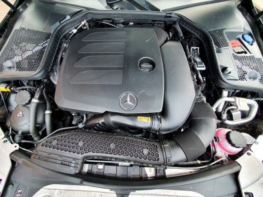

BTW, this is how you check the coolant level:
With a cold engine, the level should be up to the mark on the plastic strip inside the expansion bottle.
Welcome. Take a photo of the message on the dash, and take the car right back to the dealer....

Thanks @markjay appreciate the photo. My c205 tank looks slightly different. The manual wasn't very clear first time I read it but I get it now, it is the T-shape. It's currently sitting above the T (which is expected for a warm engine). I guess the answer is to wait for it to fully cool, then see if it's still above the marker.
