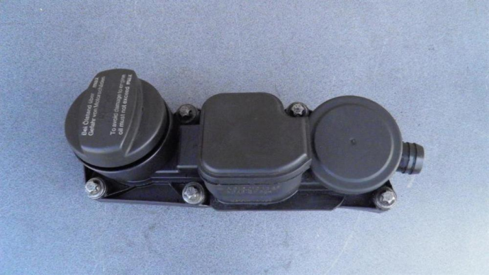

Hi all, evening...
can i ask for a bit of info please.
W211 e220 cdi.
Im looking for a crankcase breather.
on the parsouq website, im putting in my chassis number & its showing me parts.
On the diagram its number 50, part number-- A 646 010 12 62
When i go looking for the part not much comes up. or if any thing does its sell a kidney time.
Ive looked on ebay & autodoc & there showing me just the breather
Can this part be cleaned out & reused. or is it just throw away.?
any help be appreciated.
thanks all.
A 646 010 12 62OIL DRIP PAN50OIL SEPARATOR

hi all.
by the looks of it my part (well my fathers car) is this 1 below.. the car is w211 e220 cdi 125kw 170hp.
I can find
I can find the other part number A646 010 1462 which looks the same. but not sure.
any ideas please.
thanks all.

Hi all.
Cold out there, -1 at the mo', 6.45am.
Yeah.. changed the above breather, I could only get it from main dealer €140, for a bit of plastic I thought was dear.
But yeah, done the job, all ok.
& I like I say, there was no oil around visable & only white smoke from the tail.
Car (I'm told) runs like new..no white smoke.. power is up.
& there was visable damage on the old part, & even tried to blow through it & ok, broke the lid off it & the diaphragm was ok. So no way from my inspection of why the part failed.
Hope this helps someone out there.
Talk to you again.
Drive safe.
Thanks all.
So sorry petrol Pete,
I've only just seen your reply.
We did cut the thing, obviously to see if in future we could rebuild it or change internal parts, but yeah...no.
There was just a spring & the only thing I can call is it like a speaker.
If you can imagine a speaker & remove the magnet & replace it with a spring.. & the thing like is a lung it breathes / pumps some how.
Sorry for my madness of description.
Personally I don't see how it can be fixed, just replaced. & It did stop white smoke.
Sorry for not getting back to you till now, & I should of took a photo of insides, didn't think.
