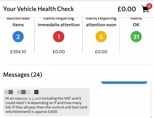

On the next day morning, after OBD scanned over my car, the garage informed me that "Multiple air and pressure related faults stored, we will need further investigation to establish the issue." A £85 investigation cost was then charged and the investigation began. No update since then until the following day, I was told by the garage that " Air leak test completed, no faults found. Mercedes technical support have been contacted and have produced a test plan for the issue. Test plan followed and we have found an issue with the fuel delivery timing. The timing of the fuel delivery is predominantly controlled by the injectors and engine control unit. The next stage is to remove the injectors and send for independent testing. Price is for injector removal and testing, this process takes 3-5 days.". A further testing cost of £269 was requested. There's nothing I could do at this stage so I authorised the request and let the test went on.

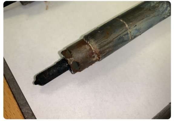

No update since then until today. I have been updated with the following message: "ALL 4 injectors have failed, we have to wait for some more info but the testing company has said that the way they have failed suggests that the fuel delivery system may be contaminated and a foreign object has gone through and damaged the injectors. This isn't good news as it means we would need to strip the whole fuel system apart and it may be a worn high pressure fuel pump starting to break up. Once I have had more info I'll chat it through with thechnician and see what options we have. At the very least it will need 4 injectors...".
I am feeling really hopeless now... Not only because costs that definitely will be incurred has reached the mark of £1800; more unknown costs seems like be there waiting for me (The garage told me they need to "strip the whole fuel system apart"; costs will be incurred. If NEW high pressure fuel pump may required, £££ will be incurred... I have no idea about the fuel pump replacement cost but after searching on the internet it looks like pretty expensive...) :(

Thanks for suggestions:) No black smoke visualized at the point of breaking down and the EML didn't turn on. I didn't try to accelerate since the noise arisen so don't really know if the power loss existed. The only symptom I found at this time was the "Ka Ka Ka" disrupted noise from the engine, which was intermittent when engine loads up and persistent/obvious when engine is idle (according to the mechanic attended the breakdown recovery the noise seems from the camshaft). I'll ring the garage tomorrow morning and request them to send me the detailed report. To be honest its quite hard to reach them by phone. All calls towards them are received by a third-party call centre and they always promised the garage will call back soon which never happened!

Now from your photo posted, the shop is using Autologic (I/We have three of them in the shop) and they are showing you what is called a snapshot .
Its a very good shop diagnostic tool , meets Dealer level service .
So the task at hand is to base line the engine and determine if its mechanical or a fuel related condition .
Basic common industry practice is to pull the injectors and test them.
They appear to have done that!
If they came back failed ,the question is why did they fail abruptly ?
This is where the test results are useful, in fact really necessary with details.
If they are hosing badly or the tips are not atomizing fuel why is that? Begs the salient question?
Now the most common issue of abrupt contingent failure on this side of the pond is to down to the High Pressure Injection Pump (HPIP). Internal failures no less!.
In short, the pump starts to break up, shedding swarf into the rail(s) ending up in the injectors making the needles stick and in extreme cases cracking or blowing off the tips or injector sac.
This condition must be ruled out as job #1 and part of the engine base line IF the injectors show swarf contamination or excess wear. Again the test details almost tell all!
Any doubts in this area and we remove the HPIP and tear it down for examination.
The first thing to fail are the piston return springs, fragments/swarf get pumped into the rail & injectors.
Should this occur its a big clean out job! (Read $$$$$$.)
