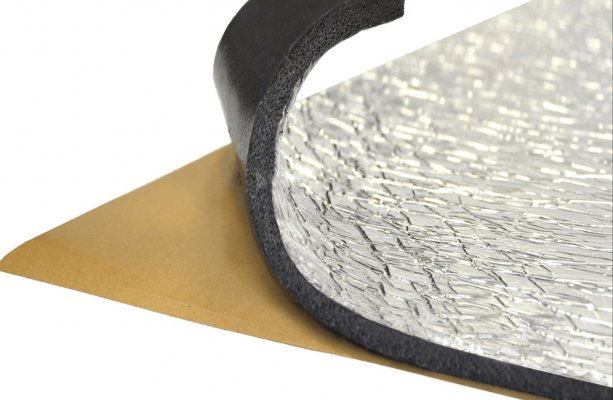

Hey guys,
Well.. as you can see in the photos the sound proofing has started to deteriorate and break away. It's annoying as if you touch off it it starts to break off and find its way into the MAF.
Anyway, I am wondering what I could do with it while I have the bulkhead out. Is there some kind of heat proof compound I could apply to seal it up and stop further deterioration?
I was also thinking of just folding it back into it's self so it's out of the way?
Any thoughts? Thanks

Would this be what I am looking after?
What would you suggest I do? Replace it all, overlay or just cut out the worn bit and replace.. is it super sticky adhesive on this stuff? I suppose after 190k miles, I could do worse than replace the lot.

If you are not looking to transform the car into a concert hall... and all you want is to restore what was originally there... why not look for a second-hand one on eBay? There would be a sticker with the P/N on it somewhere, or you could look it up on EPC.
BTW, these are about the best in the business:
But again, it depends on what you are trying to achieve.

I'll have a look. The E350 this is going into has 198k miles so i'm not looking to spend big bucks really (Dynomat). Just want to restore at least what was there before.

Yes reinstalled stock liner .
There are many quality alternatives to Dynamat products often cheaper .
Silent Coat & CTK .
Another MB one is going to be quick & easy and probably not too expensive (and should last another 198k miles :D). I replaced the one in my SL a few years back.
And I'd go for one from a vehicle sound proofing company , the product will be far superior .
Could well be, but it's not Mercedes, besides, do you really want to silence that engine ?
Stating the obvious really but if you are going for a stick on, buy some quality degreaser first otherwise it could end up more trouble than it's worth. 10 minutes of thorough cleaning will pay dividends

On one hand I think I want to leave it.. on the other I want to go all out and replacing that OEM proofing with some better stuff and also dress up the bonnet too.. If I go down that route would I see much of a difference?
Thanks.
....On one hand I think I want to leave it.. on the other I want to go all out and replacing that OEM proofing with some better stuff and also dress up the bonnet too.. If I go down that route would I see much of a difference?...
I think you need to decide what you wish to achieve. Is it for aesthetic purposes, practical, i.e. soundproofing, or returning to OEM look?
Decide on this then you can see what is the best option for you

My feeling is that I will go for a dedicated deadening brand which should be better than OEM and I would hope it will reduce clatter.
Currently looking at Silent Coat, isolator + buffler for two layer approach. Is there any value in doing the bonnet too. Will that only add value for when I drive with window open? I can't imagine it would make a difference with engine close.
Not interested in OEM as I think better bang for buck on others. Hidden in engine bay anyway and I plan on driving this baby into the ground..It represents my first foray into DIY wrenching and I must say I am secretly enjoying things breaking in it :p
Two layer approach always best , can't remember what car but here's it's oem soundproofing in the boot sides .
Sound deadening material companies then up the game with higher grade , water proof , heat and chemical proof materials .
