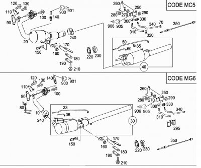

Got error code P1402- DPFE hose upstream clogged/off & P0473- Exhaust pressure sensor circuit A high.
Causes my Vito w639 120cdi 3litre v6 to go into limp mode until code deleted!
Was advised to replace the dpfe sensor & the 2 Hoses with original parts as cheap parts fail & the Hoses also get clogged over time.
I've heard it's tricky to do on this engine & heat shield needs to be removed??
But where is the sensor located exactly?? Any pics would be great :thumb:

but there were numerous modifications to the exhaust system and sensor locations as MB strived to keep up with more stringent emissions. Best go into your local MB commercial dealer parts counter complete with your chassis no - they should be able to help with part nos and location

Hi its drivers side where in exhaust turns up the back of the engine has two hoses to it
and its up behind the exhaust heat shield fixed to the side on the inner wing
