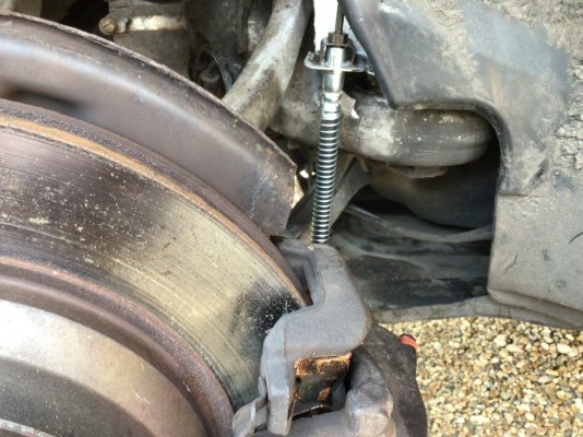

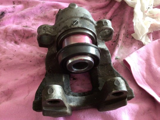

IMG_2736.jpegIMG_2738.jpegIMG_2741.jpegIMG_2740.jpegBeen a busy few days with the E class . I took the rear calipers off and changed the pistons because the original ones are a plasticky compound that apparently swell with heat and age . I changed the dust covers and internal seal as well . I did split one new dust seal with a screwdriver when bedding it on so had to wait a couple of days for a new one to turn up .
Last year I had an advisory for rubber brake hose perishing so I took this opportunity to change all 4 at the same time . Three went without an issue , but one of the fronts rounded off the nut so it took an hour to file down the 11mm nut to 10mm so I could get a smaller spanner on it . With a bit of freeze spray and more penetrating fluid it finally worked .

View attachment 155628View attachment 155629View attachment 155630View attachment 155631Been a busy few days with the E class . I took the rear calipers off and changed the pistons because the original ones are a plasticky compound that apparently swell with heat and age . I changed the dust covers and internal seal as well . I did split one new dust seal with a screwdriver when bedding it on so had to wait a couple of days for a new one to turn up .

Replacing the pistons is cheaper than new calipers , that was my motivation.

Back on topic, it's a shame that the composite pistons swell as in principle they were a better idea than rusty steel ones.
The kit arrived yesterday, so hoping to get it rebuilt prior to the sleet falling.
But getting the snap ring of the dust cover to seat onto the caliper is turning out to be a bitch,
any tips?
Got the 1st one on. Easy with the right tools.
In the end I took the caliper off to work it in the vice. Then remembered I have a ball joint press kit. With the right bits the dust cover went on with ease.
