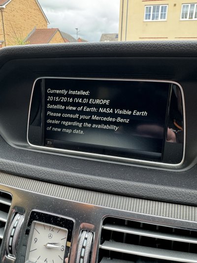

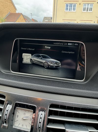

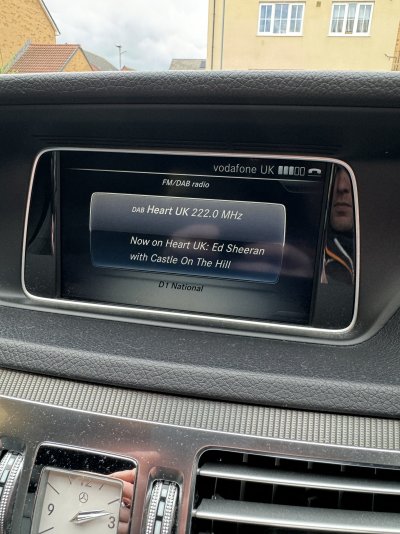

I have a 2016 E220 (W212), I believe I am running NTG5.1 although not my speciality so please correct if I am wrong. To the best of my knowledge no software updates have been installed since leaving the factory. I was first told that I cannot activate factory Carplay and had a 3rd party device installed, however the audio was routed through the AUX input and the quality is terrible - the system is also very buggy so I will be having it removed.
I've since been told by another user that I CAN activate factory Carplay but need the NTG software updated first, can anyone help me confirm if this is true? I don't have the 'phone' USB ports in the centre console, just two regular ports. Photos attached which will hopefully help.
Thank you in advance!

Contact comand.co.uk / comandonline.co.uk - you're going to need firmware / licence / etc to do it properly and reliably
Mercedes correct procedures requires the armrest ports replaced
R
As Richard said.
Late W212 cars were fitted with CONAND NTG5*1, which as you rightly said does has native support for Apple CarPlay (but it requires activation).
Thank you both, I will contact Comandonline. I did more 'googling' after posting and it sounds like I need the NTG software updated, then an activation.

Proper and legit activation is done via SCN coding.
The pirated version uses an OBDII dongle to upload a hacked version of the COMAND software (thus avoiding paying anything to MB).
Apparently, either will do the job. The main difference (apart for the obvious IPR infringement) is that if someone tries to update the COMAND software in future, the legit version will retain the Apple CarPlay, but with the pirated version the Apple CarPlay hack will be overwritten and lost.
