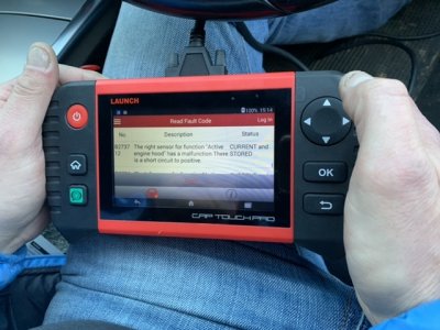

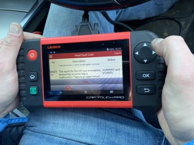

So ive bough this after crash mercedes w212. Changed the fuse from the juction box that was popped now I still cant start it the car loads up all the electricity but it doesnt crank .
got this error messages from reading

Possibly the pyrofuse MR8 in the prefuse unit , triggered by Supplemental Restraint System control unit- You may have to renew the whole Prefuse unit if you can't get the pyrofuse separately.
