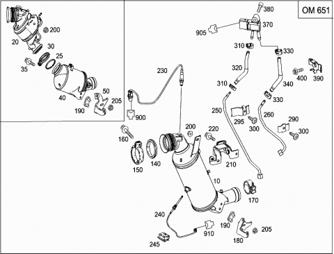

    Any chance you might have some insight into details of location of said pre-cat / upstream O2 sensor? DIY to replace?

    No. 230 in the picture

    Thanks again for the diagram. In term of location, is this situation on the about lower middle of the drivers side (near to the front off-side wheel)?
    Thanks to your help, I managed to order the needed Bosch part from eBay for £70. Mercedes were all to happy to sell the same part to me for £266.40! And of course, they would strictly not give me the part number.
