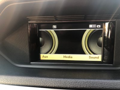

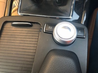

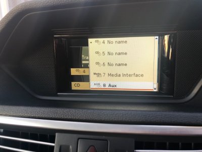

I have found the jack connection and got an aux lead connected from car to iPhone but how do I switch the source to play the music from phone ? There is only buttons for cd or radio
When in cd mode, with comand knob (on central console) you can move down to Media(like with joystick), press comand knob and new drop-down list will show. Rotating the knob go to AUX, press knob and you’ll be in AUX mode.
Great I will try in morn
I love the car had 2 weeks now but only thing let’s it down is basic basic stereo with no hope of changing unless I want a £1500 bill
This is how it should look like
CD screen:
This is the knob for navigating through the screen:
Drop down list:
Aux screen:
