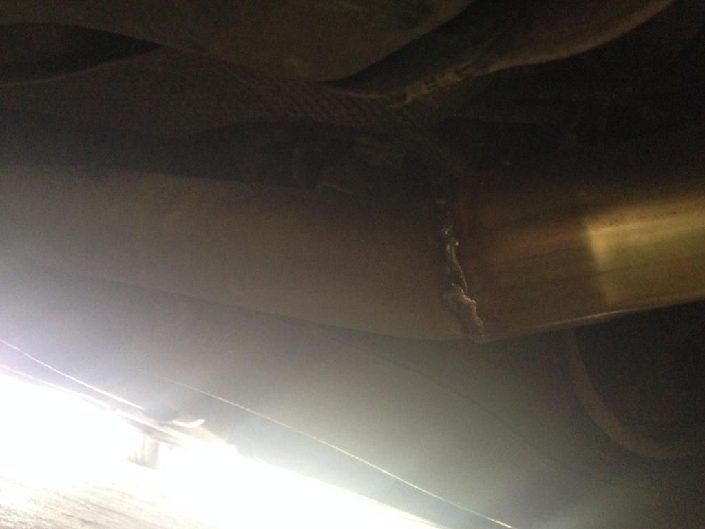

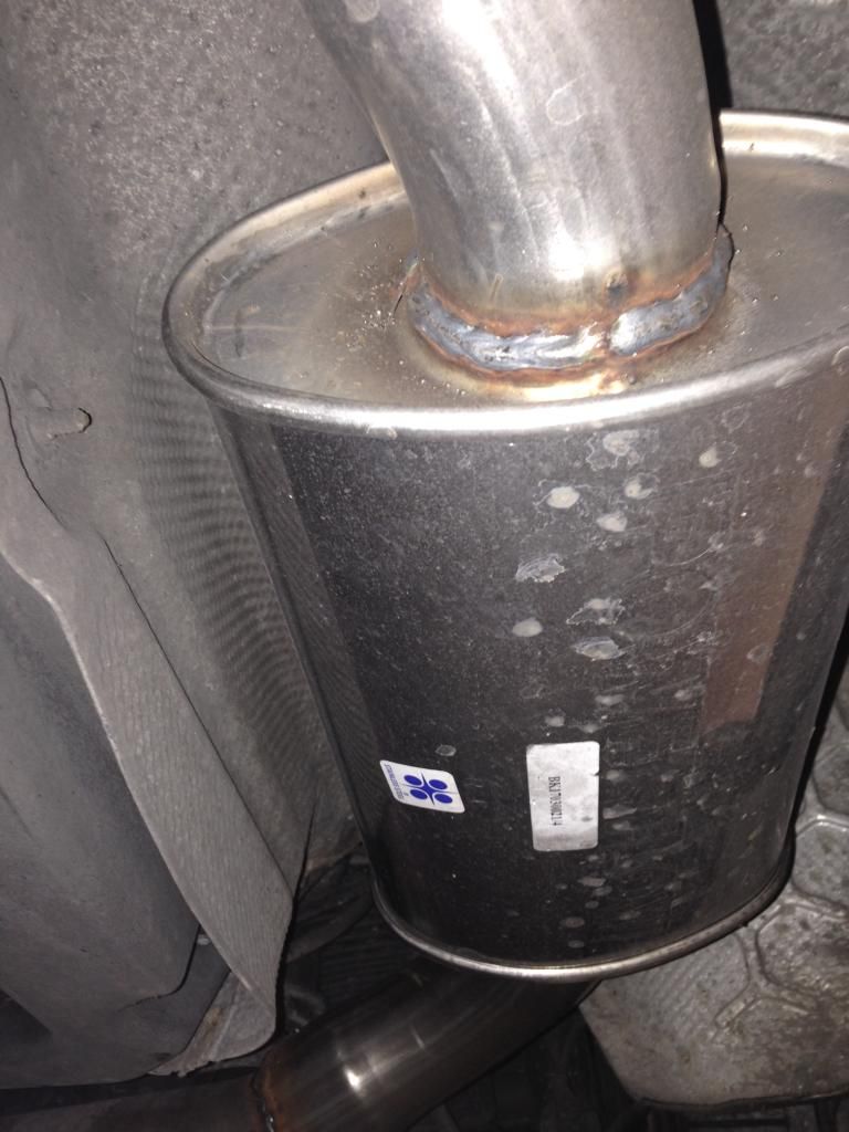

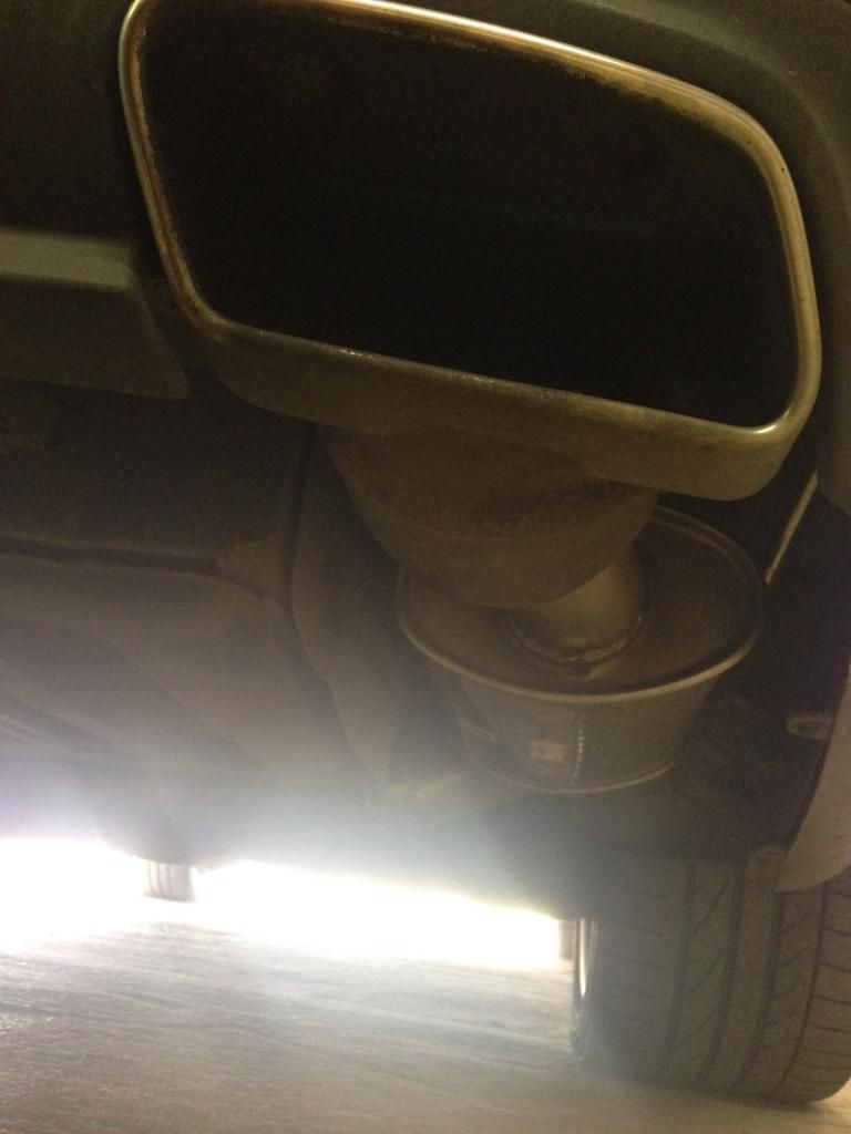

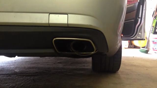

after owning my e500 for a couple of months i was hoping to unleash a bit more noise from the v8, so after a phonecall to the very helpful eldin at EMP i booked in for the sec cat and resonator delete with X-Pipe replacement. This did make a noticeable difference but still not enough from the fairly docile v8. So another trip to EMP to sort out the back end of the exhaust, and after a week of having no silencers (big mistake) they fitted some smaller Powerflow rear silencers. Really happy with the noise now, a real deep grumble without the chavvy rasp that i had with no silencers! hopefullly lowering links and maybe some new wheels in not too distant future. Thanks for reading, apologies for the rubbish video quality and will hopefully get some pics of the exhaust work over the weekend. Cheers, Rob
