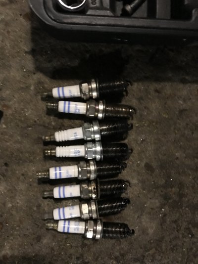

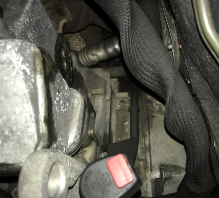

Hello,
I recently got an E55, all was well and after a steady cruise for around half n hour or so, I started to notice what sounded like a misfire when I would press the accelerator from around 10-20mph. So, when revs were low. Thewn I approached a set of lights and felt the car shaking and a bit of vibration and then the Engine Management light appears. Scanned with OBD2 and it showed me P0308 misfire on cylinder number 8. I am looking to replace all 16 spark plugs and the coil pack for number 8 for now.
I have read possibly the valve cover may be leaking onto the ignition leads?
I wanted to ask, if anyone else with an M113K engined vehicle has experienced similar misfire situations and what course of actions you took to get the matter resolved please?
Many Thanks
