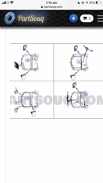

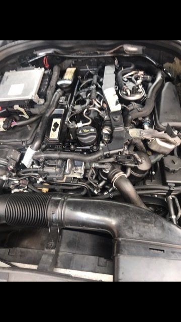

Hi
I’m having engine wiring harness issues with
W212 e250cdi
Vin no 2120032A299230
On line catalog multiple part no are coming
Any way to know the exact part no please
Would really appreciate
The sticker is completely worn out
And injectors wiring pins are bad including the wires
Need to purchase engine wiring harness

Whats wriong with used parts ? these parts dont wear .Get to a good used parts yard remove what you need , and splice the plug in much faster than buying the crimp tools to do it
Hi
This harness wiring is deteriorated around the injectors site with multiple areas where insulation has withered off
On eBay there are multiple options and quiet cheap just need the correct part no for my vin
I would’ve done as your saying but it’s too far damaged at multiple areas

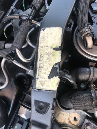

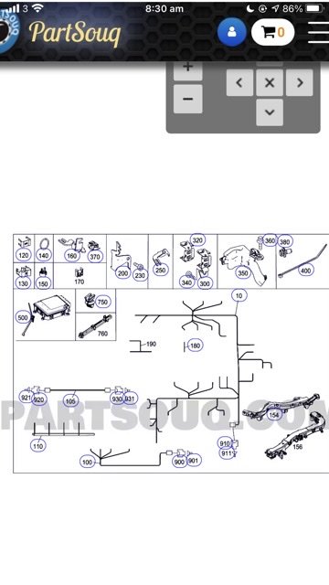

These are the pics the number is completely worn out
E250cdi
