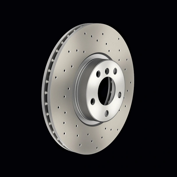

Anyone used Eicher (eurocarparts) and what disks would you suggest ? Stick with plain vented or go for drilled etc ?

As for drilled discs....:
My view is that if you had no issues with the car's braking performance so far, then the drilled discs are mainly for the aesthetic effect, which isn't a bad thing.

Drilled discs offer no benefit in normal driving. The holes can increase pad wear.
