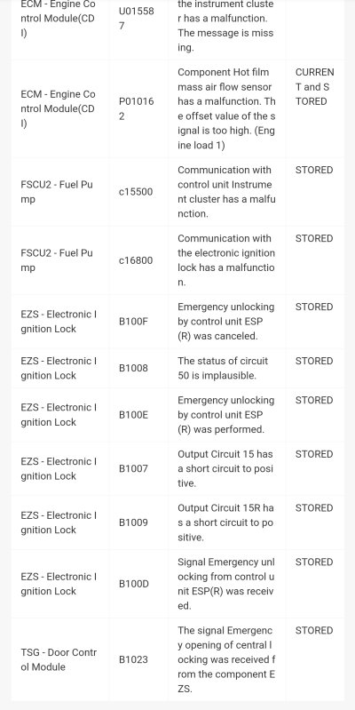

Hi, I bought a Todondiagnostics scanner after I was charged £1880 to clean the dpf, I've since had a few issues with my sprinter 313cdi 2013, I've attached a report from the scanner, the van key won't turn, it eventually does but can wait 15 minutes, the ESP light keeps coming on in yellow and I've had the brake force distribution light coming on in red, I changed the brake light switch and it seems to have helped. I'm not sure if anyone would know what this diagnostic report means? I wondered if it might be the relays as it seems like everything that can go wrong has gone wrong? Any help would be greatly appreciated. Thanks.
