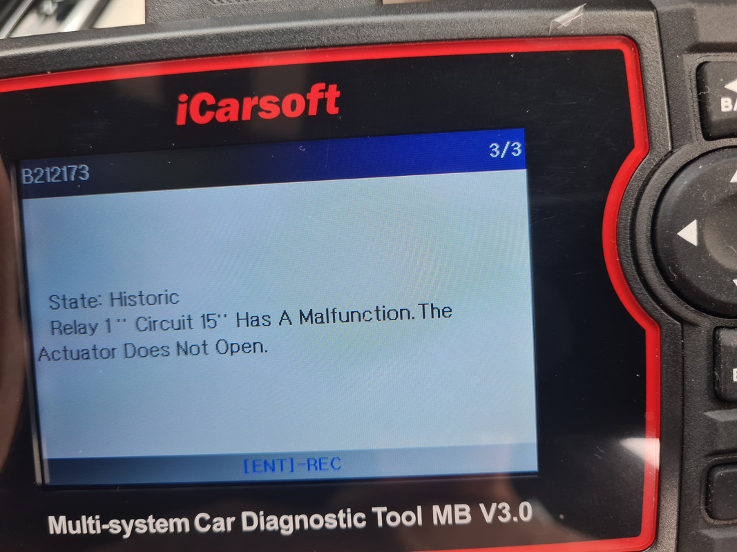

HI everyone. I have the engine management light on, no loss of power, all electrical consumers work ok.
The car has detachable towbar, with the dedicated towbar wiring kit fitted to the Rear SAM unit. The only potential issue I've noticed is when engine off (ignition key removed) ,when I plug caravan electric cable into car 13 pin tow socket, the rear tail lights ,lluminate. When I start engine, the rear tail lights go off.
I've performed a scan with my icarsoft MB v3 see attached photos for information. When I clear fault codes they return after a few days, or approximately 20 miles. Can anyone suggest the best course of action?
Sorry, see attached photos for i carsoft information
Hi guys. I've just done another i carsoft scan, and it's coming up with another fault code, in addition to the previously posted fault codes! ( see attached photo).
Dose anyone have a rear SAM wiring diagram, for a 2011 S204 , so I can identify relay 1 , curcit 15.

Circuit 15 is ignition live. Usually a black wire.

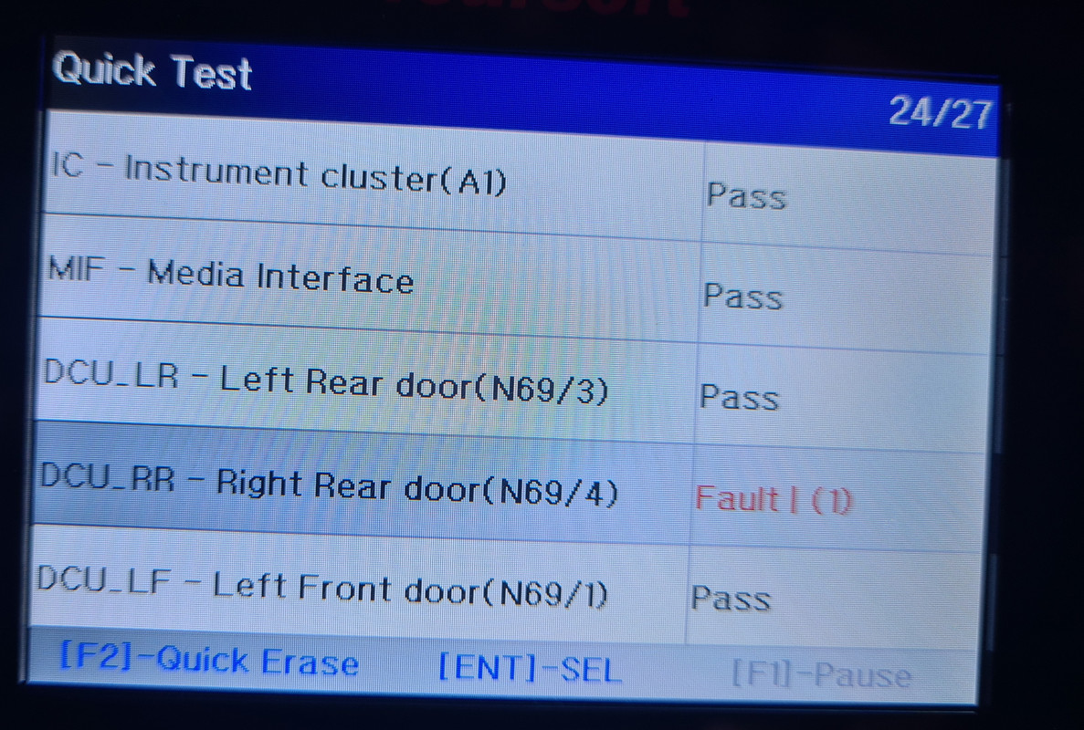

Update. Checked the rear SAM wiring curcuit 15, i couldn't see any wiring issue. Checked the westfalia dedicated towing electrical loom, i couldn't see any issues. I then checked the car 13 pin socket and sprayed with WD40, & the caravan lead towing plug. I then plugged lead into car socket, and rear car tail lights DIDN'T illuminate. I then Did a scan, with the icarsoft, no rear sam fault. However another new fault appeared -:
DCU_RR - Right Rear door(N69/4)
Fault I (1)
990915 . State: Current and Historic
The Output For Actuator Motor " Additional Door
Lock'' Has A Malfunction. There Is A Short Circuit
To Positive Or An Open Circuit.
Thing is right rear door lock, and all other 3 doors are working OK!
Fault I (1)
