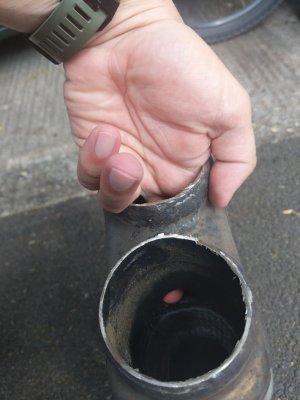

Did I spot a cross-over pipe (or port) part way down the resonator box, linking the two sides?
Thanks,
Yeah it has a tiny link between the to, I guess its to cover the eventually of a mismatch between both exhausts:
See attached picture with my, erm, er finger in the hole.
Thanks,
Oh! Matron!!! :eek::D
So that means you have lost any 'balancing' between the exhaust banks? You were advised there was no benefit to adding a cross-pipe as you did on the CLS55, which didn't have one originally. Just wondering how this may effect the exhaust scavenging?
Multiple specialist advised, on a turbocharged car is no point linking the pipes as it does nothing to increase the sound,
I can only imagine Mercedes have done this just to cover their back in case there is any difference between the two pipes to even it out
Do you have a picture of the new pipes fitted to your cat Karl? Can't remember seeing one on the video and curious to how it looks?
