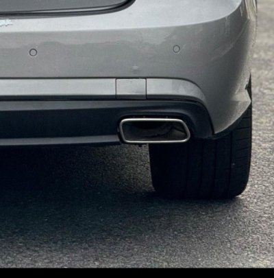

I love the look of my PFL 212 sport....all except the bland looking tailpipe. Id like to change them for more AMG or Brabus looking ones......but I don't want to change the bumper. As you are probably aware they are not part of the exhaust at all, although the gases do flow through them, as that ends just before the bumper mounted tips...so as long as the mounting holes are the same spacing the tip should fit. Anyone done this?...if so where did you source the parts? There are a couple of Brabus looking ones that claim to fit on Aliexpess etc....but I'd like to hear from anyone with experience of them first....or with a alternative ideas....such as twin round or oval pipes each side.
This is what I have now..... one each side of course.
