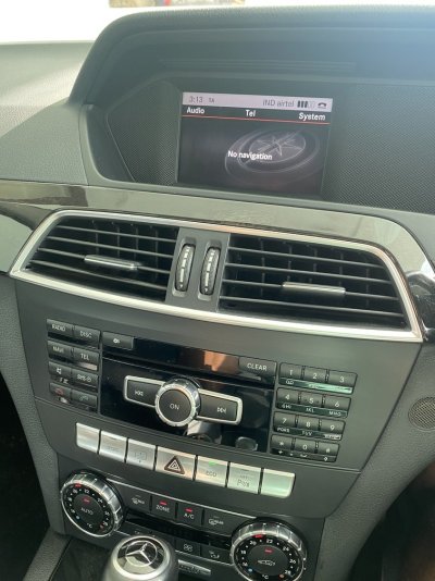

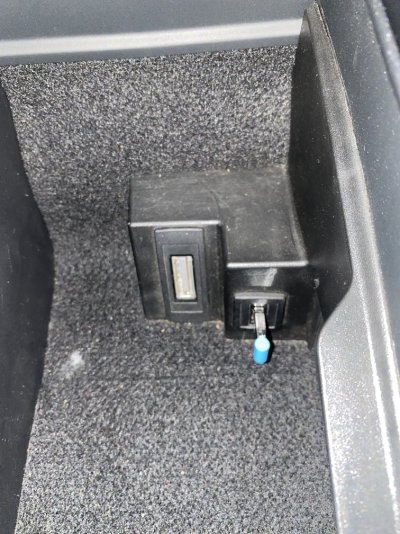

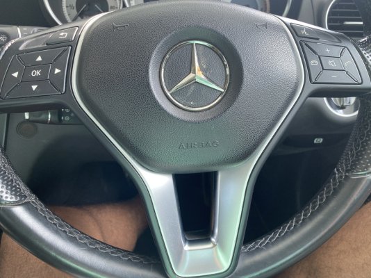

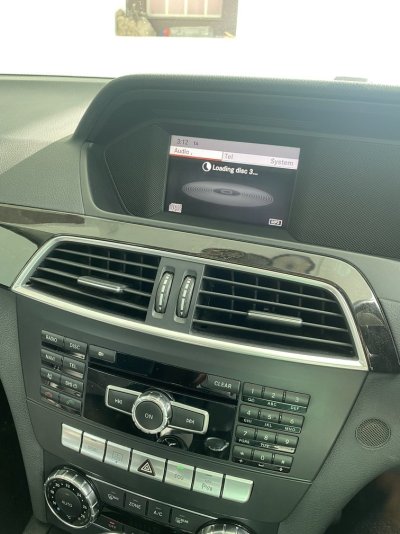

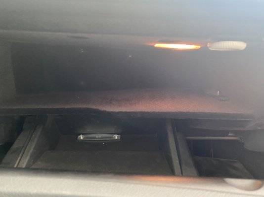

thank you so much for the inputs , but im not aware of the Becker sat nav and I don't think I have it too . have attached images for further reference to check the systems by yourself .lingutroinic button is there in the steering wheel but even that doesn't work . and @dest whats the brand / wireless car play module you use . and my car doesn't have reverse camera as well planning to retro fit as well for the car specific . @markjay im so specific about the video playback , wireless Apple CarPlay , navigation and reverse camera . this is all what I needed . thank you so much for helping guys .

This shows how the Becker is swapped, it looks like you don’t have it from your pictur, so you would need the old style similar to what I originally had.
