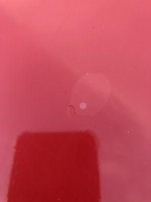

Hi guys here’s a few photos of my beautiful flakey lacquer on my 2013 FOR c220 AMG...... only came up very quickly a few days ago but after looking closely you can see little bubbles all over it feels pitted as you rub your hand over her! So disappointed
The ones where white primer is showing are caused by stone chips, so they are most certainly not the problem to draw the dealer's attention to.
It's the little bubbles (micro-blistering) that you need to concentrate on, as they are the classic Fire Opal Red defect. The best photo that shows that is the top right-hand side of this one:
One thing to be aware of is that if the car has had any paint repairs to the affected panels during its life that were not carried out by a Mercedes-Benz approved repairer, then MB will almost certainly push back on a claim.
Yes unfortunately there are a few stone chips which is not good..... but there’s enough of the real problem all over the car unfortunately. Thanks again for your help xx
If you read through my thread about my lacquer peeling, there's a link to a German paint manufacturers document that clearly shows and states that lacquer peel like some of yours (and certainly mine) is a manufacturing defect caused by poor adhesion of the lacquer coat to the base coat, caused by improper application of the base coat. MB ignored this completely and said it was all caused by stone chips, so expect the same response about that element. However, microblistering they cannon ignore, there is too much evidence and provenance about that, both here and in USA with Mars Red, so keep on them!!

So I washed her and dried her and you can see tiny micro bubbles all over!! How did I not see this before? Took more pics too9742FFEB-D2CF-4032-9DAF-6B9460D8C9B7.jpeg . I’ll keep you posted as to how I get on. Thx you guys x 9742FFEB-D2CF-4032-9DAF-6B9460D8C9B7.jpeg9742FFEB-D2CF-4032-9DAF-6B9460D8C9B7.jpeg 834CCBD7-C397-4A52-8400-220127755185.jpeg

Soooo, just out of the body shop, it’s a total respray, under warranty, they take it in, take it all apart take all paint off to the metal and do a whole respray.... not the bumpers but for £360 you can get them done too!! Thanks for all your help guys! Xx
Result!!:):):) Hope they provide you with a suitable courtesy car while the job is done, as they'll have your car for quite a while to do a full body respray. Happy that we on here were able to help you.
That’s a really positive outcome, I am pleased for you and hope that you are content too.. great tenacity, good to be supported here too..
