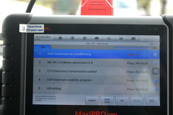

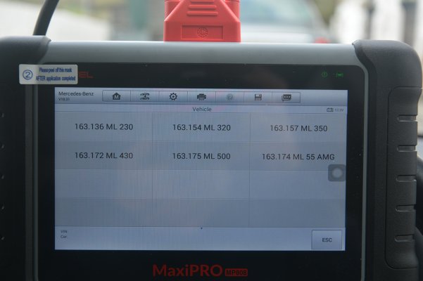

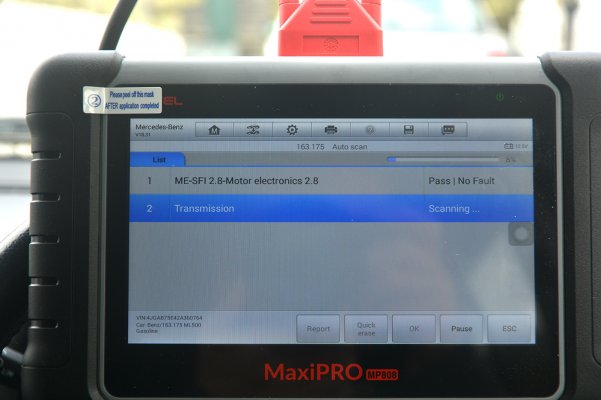

Plugged in the scanner and the screens below are what i found.
No P2001 fault showing and only one fault with the Air con.
He reckons the throttle position sensor needs re-programmed, but my diagnostic scanner cannot do this.
So does this scan show all okay, and mean the throttle position sensor and the throttle body somehow do not know what is going on between each other, hence now, no throttle?
Or is the P2001 code just waiting to trip in again and show a faulty ETC module?

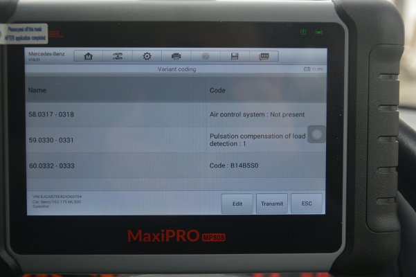

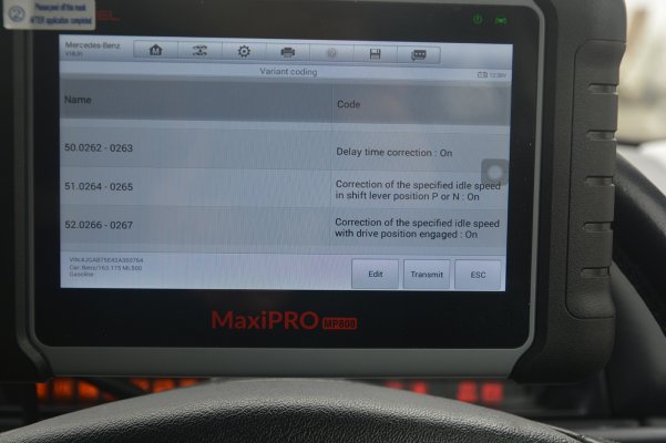

next set of screens.
All reading this who know these diagnostic scanners and different screens will find this easy, but this is all new to me, so forgive my ignorance in getting going on this.
The scanner is an advanced one, way beyond just a code reader, and clear fault code, so I know to be careful with what I look at or touch, and make sure i do not alter anything, as this unit allows me to basically wreck a vehicles etire electronic computer systems, the same as you can crash a computer, or maybe even worse.
