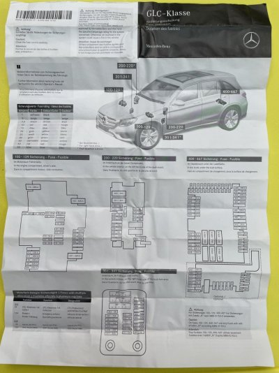

noticed last evening my overhead control panel not illuminating, no lighting to interior light controls etc, at all.
Currently assuming a blown fuse (rather than bulb) but having checked the ‘fuse allocation chart’ tucked in rear fuse box(boot), unable to locate relevant position.
Perhaps called something other than “Front overhead control panel” 🤷‍♂️🤦‍♂️
Anyone else from the ‘collective hive’ IMG_4962.jpeghad need to check and therefore knows location please?

June 2017
312 passenger footwell 10a.View attachment 164759
Belated thank you to ‘OneForTheRoad’ for this response, was indeed 312👍
Reading/translating the original car provided ‘fuse allocation’ (generic?) sheet, 312 is indicated as covering multiple ‘enrich & antitheft alarm system, panoramic roof and windscreen wipers (which were actually working throughout) so lord only knows how anyone can rely upon such an imprecise diagram, presume technicians have much more accurate layouts, based on VIN/model batch info??
Responding so hopefully of use to someone else in future👍 🎅
