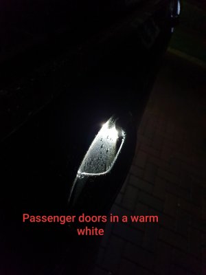

LED's degrade over time, the drivers door one has probably been replaced & therefore newer. When the bulbs get near end of life they turn purplish.
AFAIK Mercedes only use one type of LED for the door handles.
Here's mine

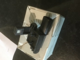

My last picture shows the lamp fitting.

I see the LED that arrived today is revision 13 the only visible change is the LED and it’s mounting post are covered in a clear potting lacquer. It could be moisture causing the premature failure.
