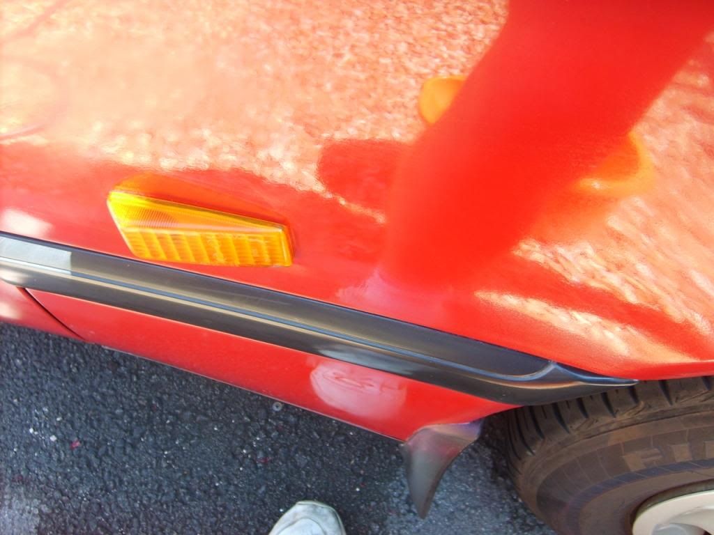

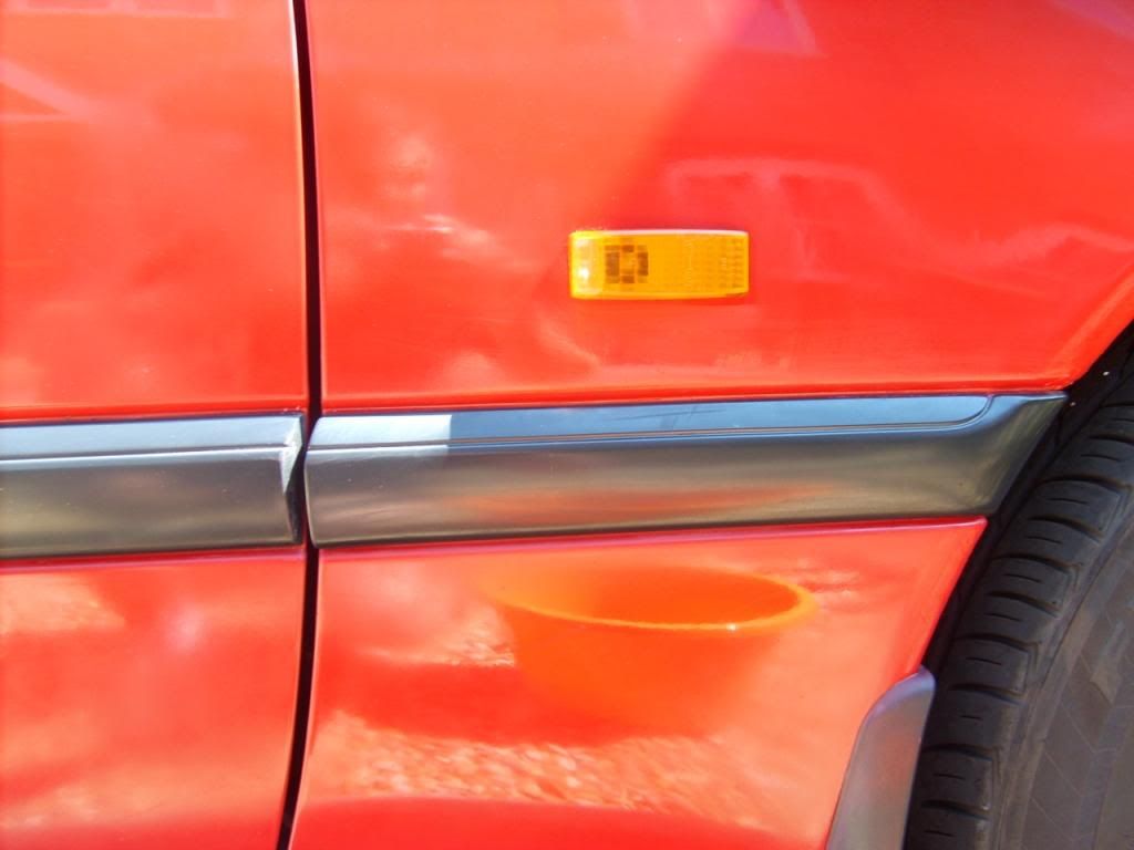

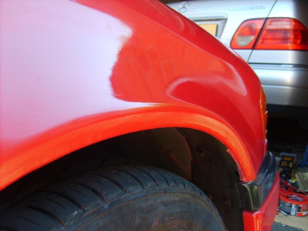

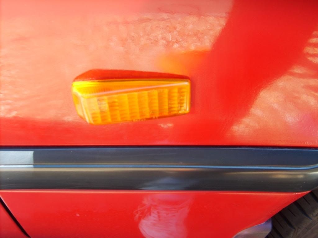

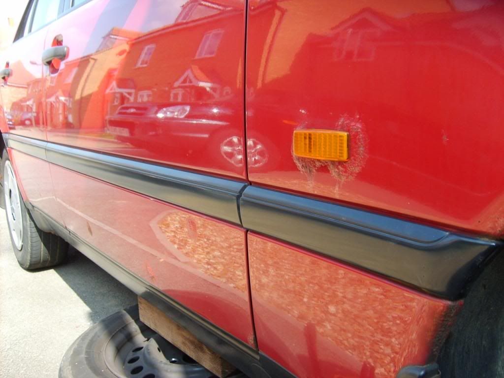

Here are some before and after photos but still needs a bit more buffing with G3 (ran out)
h
The white bit on the inner lip above is in fact metal which wraps inside furthe up, i only mention this as it looks like a long sliver of filler.
Thanks all, a few more bits to do but very pleased with the result.
Walking up to the car you cannot really spot the difference unless you are looking for it, even the neighbours have come up and commented.
