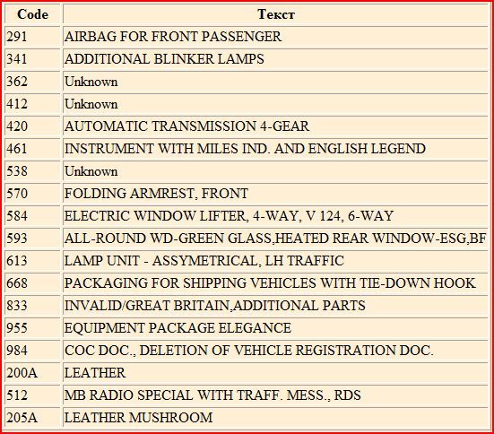

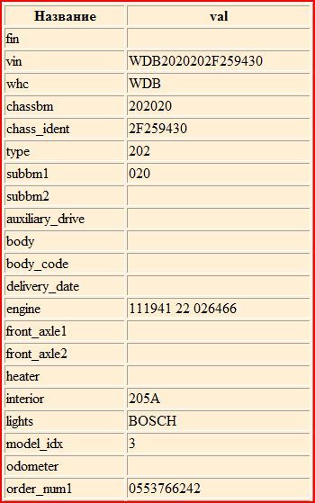

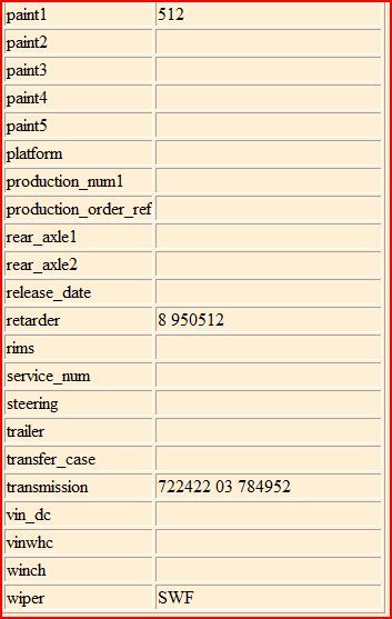

With that in mind, I was hoping to read the chassis code but can't find a link. Anyone know what this actually bring up? :dk:
WDB 2020 202F 259430
Here you go. Ìîäåëü (Link to Russian site) Enter VIN number and click on the button to the right. Then select the Europe option and you'll be able to search for the various components.

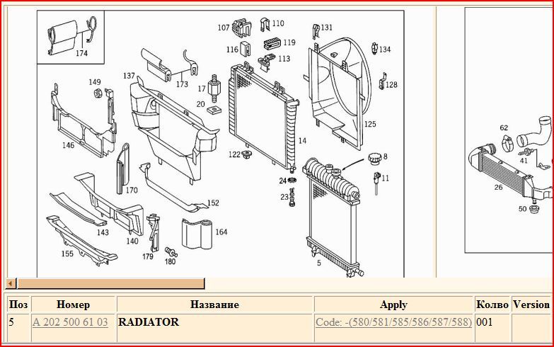

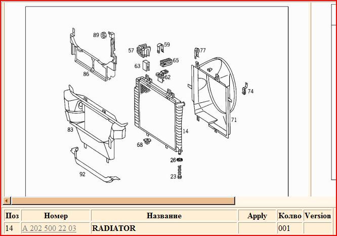

I've just had a look at the radiator diagram and although it shows two different ones in the European diagram it only shows one part number against it. The un-numbered one is listed in the Japanese parts diagram. Hope that makes sense.
Edit: Pictures may explain better.
European Parts List
Japanese Parts List
Superb that man. Thanks a lot. We think we have it sussed now. Hopefully right part will be there on Monday!
