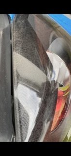

So I have tried a lot of products on headlights over the years on different cars with some good results.
However I was blown away by the ease of use and outstanding results of this product. (I’m independent so not plugging this).
CERAKOTE® Ceramic Headlight... https://www.amazon.co.uk/dp/B084RQKLV8?ref=ppx_pop_mob_ap_share
Have a look at before and after. 20 minutes work with outstanding results. If I have to repeat every year it’s still cheaper than replacing the units. IMG_1753.jpgIMG_1752.jpg

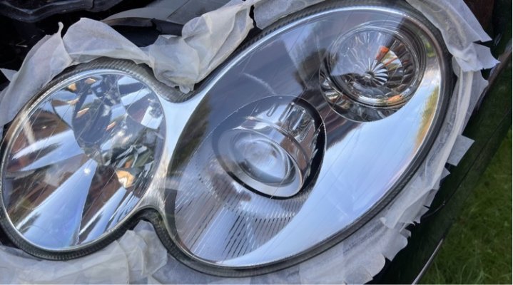

I recently used a similar kit from Holts on my Vito and wasn't happy with the results at all ... very difficult wet sanding with disks on curved light units (flatter ones might be OK).
I bought a softer backing plate and two foam pads ('heavy cut' and 'polish') along with appropriate compounds from a detailing place, and that worked fine. I only used the sealant from the Holts kit.

My problem was not so much the yellowing but minute haze cracks in the plastic where the sun heats it on the top.
The latest product has removed/masked these and now looks crystal clear.
It won’t last forever but it’s perfect for now.

Yep ... chrome polish is relatively mild I think. The 2-stage process with cutting compound and then polish (using foam pads in a drill) worked well ... this is the same light cluster after that:

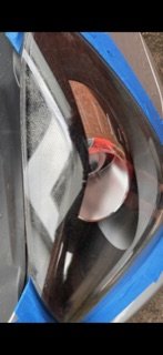

Did mine yesterday… Think I have before and afters… The UV protectant goes on a bit like nail varnish and takes three days to cure!IMG_7304.jpegIMG_7303.jpeg
Oh and sanded with a drill on slow speed 600 grit 1200 grit and 2000. Take your time keep the paper wet and dont use supplied polish, I used Meguires compound and polish. Here’s a link… I used this kit.

kit I used has a ceramic coating to finish. It will not last forever but is far cheaper than light replacement
