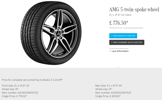

After much research all becomes clear. The E43/E53 shipped as standard with 19" Twin 5-Spoke AMG Alloys. They are staggered but also a different offset at the front and different to the 19" Twin 5-Spoke AMG alloys on non-AMG models. Both AMG and non-AMG models seem to be 9J ET49 on the rear. However, on the front the non-AMG models are ET43 but the AMG models are ET20
So the 19" AMG variants are:
Front axle: 8J x 19 ET20
Item number: A21340138007X23
Front Tyres: 245/40/19
Rear Axle: 9J x 19 ET49
Rear Tyres: 275/35/19
Item number: A21340121007X23

So it is proving hard work to find the front set for the E43 AMG with the ET20 offset. The rears are no problem but the fronts are harder to find so far. I have spoken to MB Stevenage and they can't even find the 19" alloys for an S213 E43 on their system at all to even buy new from MB. Even though they shipped on the E43 as standard. I believe the 19" alloys were also standard on the E53 too

Also just worked out that the end part of the code is the colour code so 7X23 Night Edition style High Sheen with Gloss Black & Diamond Cut face and 7X21 is High Sheen with Titanium/Himalaya Grey & Diamond Cut face.
The attached doc might be useful to some I found that details the tyres sizes and alloy sizes with part codes.
