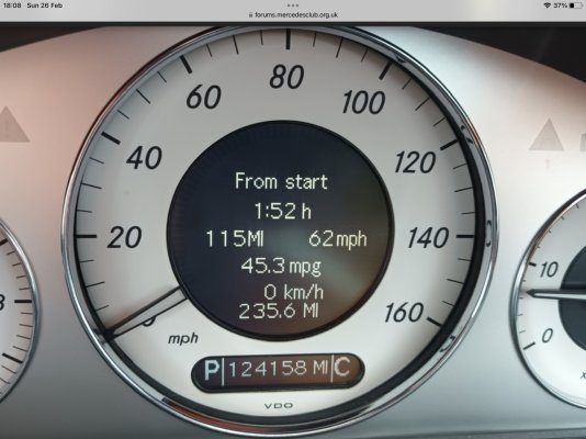

I generally consider the 642 lump to return about 20% worse economy than the 646 (2.1) engine.
On an economic m'way drive from London to Derbyshire we saw 57mpg on the dash (it's pretty accurate tbh).
I can easily see 50mpg on a run.
But Mrs Me on her 7 mile commute will see low 30's. But if I were doing her commute I 'believe' my anticipation would be better, and I would use the fuel dump less often.

Get the car on the motorway then reset the mpg trip thingy when the car is warm at 70mph , you should see nicely over 40mpg . If that’s the case it’s working correctly.
Mine is always over 40mpg in sport mode on 600+ mile motorway and A road journeys to Wales and back
W211 was never the most economical car in the world. But possibly the best car :)
What you are seeing is only a little on the low side - but not by much. Is it auto?
My 3.5 litre V6 petrol returns those sort of figures.
