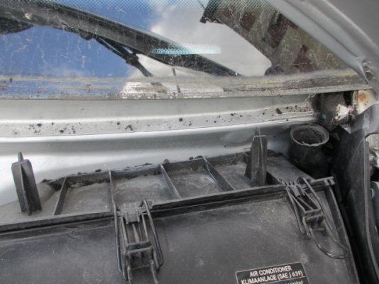

Hi Mark I have had reason to remove the scuttle from my car (2006 S203 C class) but my spray nozzles are on the bonnet - and incidentally non adjustable - Once the wipers arms are off removing the scuttle is usually quite straightforward. Just undo what screws you can see and start gently pulling it down from the windshield.
One thing I will say is buy a wiper arm pulling tool .
This is the one I have , cheap and does the job of preventing you from leverage damage on the wiper mech and/or accidentally cracking the windscreen if you slip using the wrong tool.
Photos not of your car but you get the idea of how the scuttle pulls down from the windshield, exposing years of grime under the seal !
In the first photo you can see why it unwise to put too much leverage on the wiper arm spindle. You wouldn't want to bend that bracket.
