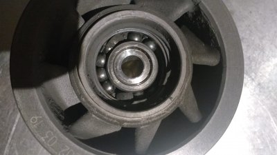

Saturday afternoon idler pulley bearing failed in the Peak District. RAC flatbed to my indie. Monday he's checking prices with MB Derby for this:

There are actually two pullies on the same shaft. A metal one for the kompressor belt and a plastic one for the ancilliaries. The bearing failed in the metal one and can be replaced. A new bearing would have cost me less than £10. BUT you need to replace the plastic pulley at the same time! I must have spent an hour with the guy at the motor factors but we couldn't find that pulley. Now, I could have bought one from Ireland for £35 but the car was stripped down at my indie and we just wanted to get the job done.
And here is the culprit. Imagine the noise when this failed.
