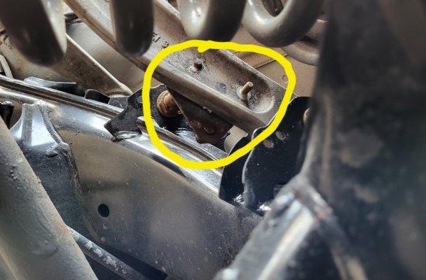

3. Everything could be removed fairly easily except the plate (and associated ball joint) that connects to the upper rear suspension arm. I could remove what appeared to be the single securing nut for the plate (pics below), but the plate appeared welded on to the upper suspension arm from how much it wasn't budging. Seeing as this plate and associated ball joint comes with a new level sensor, is there something I'm missing in removing it?
Securing nut removed from back of plate with ball joint
Front of plate with ball joint that I just cannot budge/remove
