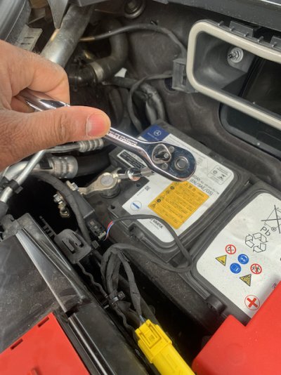

First of all disconnect the battery
1. Remove the rain cover by twisting the two clips as shown and lifting up.
2. Remove the cabin air filter box by unclipping the two sides and lifting up
3, Remove the negative terminal and place safely away
