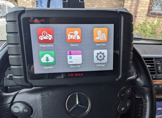

iCarsoft CR Max Review - Advanced OBD Scanning/Diagnostic/Code Clearing Tool ***£25 Off Forum Discount Code***

This is my review of the iCarSoft CR MAX Diagnostic machine which was lent to me from the guys over at LJM - who are the only offical supplier of iCarsoft units in the UK

Bought one of these 3 weeks ago. So pleased to see the money off code :) Yesterday I ordered the red adapter for early Mercedes cars too so I'm keen to see how far I can go with my new (to me) S202.
It is utterly brilliant though, I can highly recommend this unit.
is it able to do air suspension work on the 213 chassis? i bought a fancy 2 way machine that couldn't. It said it could do mercedes but it seems it couldnt do the 213
Possibly, depends on the model and what you need doing. However as with all deep down functions you will need STAR.
i was after it for calibrating and fault finding the airmatic.
this is the one i bought and returned. it supported 222, 212 etc but not 213

I’m getting the “Active lane keeping assist inoperatibve” and Actice blind spot assist inoperative” messages. Would this unit be able to diagnose those errors?
It will read the codes of course and you can try to clear them, however if the units themselves are faulty the issue will remain.

A scan tool will tell you what fault codes have appeared and you start from there. This CR Max device and run actuation tests on certain modules to test the actual function.

Hi, can this tool be used to activate features that are not yet activated. Eg. Cruise control (I’ve fitted the stalk etc)
Only STAR Diagnostic machine can do this im afraid. - dont believe anything else you read online about that.
Other Marques yes, Mercedes, no.
