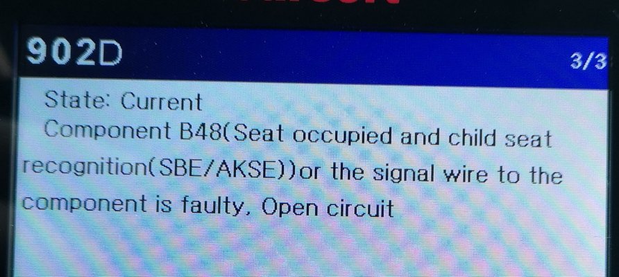

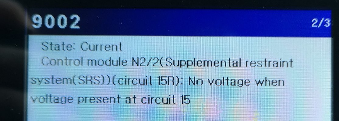

I suspect that there must be an underlying issue that isn't allowing me to erase the code, as you guys have suggested.... I was being naively optimistic that it was appearing as I had unplugged the cables on both the passenger and drivers seats (to clean the dog hair from a previous owner!).
I've attached pictures of the the error codes I am getting. I appreciate I'm being a bit lazy asking for help and I will go look through the forums, but if anyone has better experience of the same/similar fault and could point me to the answer quicker, I'd be very grateful!

Think 11.60 is out now . You could try removing the battery earth and see if things reset. Something you should have done before unplugging srs systems 😁😁

Have you repaired the broken wire listed in faults?
it may be the pressure pad sensor in the seat. Check the connectors to it are in properly. Check wires haven’t been damaged by clumsy feet.
It may either require a new sensor pad (or an emulator fitted instead), but the code might need to be reset on STAR/XENTRY.

Before going to town looking for broken wires or faulty parts always check the simplist things first, fuses 😉

I did exactly the same, unplugged the connector under the passenger seat, reconnected it, and then erased the SRS fault codes with iCarsoft MB v2.0 - no problems.
I suspect that either the wiring has been disturbed or the plug not reconnected properly etc, or there's an issue with the iCarsoft. I am suspicious however as to why the 'historic' code can't be deleted? To my mind this reinforces the theory of an issue with the scanner or cable etc.

In my case, the issue turned out to be a faulty Front Passenger Seat Occupancy Sensor, which is a very common fault. Replacing the sensor mat resolved the issue.
