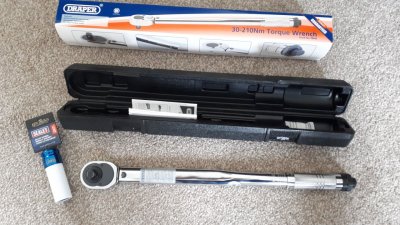

Just to illustrate the above post:
I would probably go for the Clarke one from Machine Mart as it already has the short extension which you will need for alloys. It's handy having it there in the case, with the wrench.
I've got a "Halfords" TW and it is quite literally identical to the one below except the case is red but the wrench itself is identical to the Draper one below in the blue case.
Lasted me for years and I use it a fair amount where I can't be sure the car wheel bolts were torque'd up right.
These all come from the same manufacturer, I'm sure - the branding is not even engraved or embossed - it's a plastic sticker and a paper insert on the top of the case.
Works well, and I gotten into habit of always checking the wheels are torqued correctly, after any garage visit.
Yes, I think you are right there.
Looking at the one Roger is buying looks the same too.
It's very well made and feels good quality.
