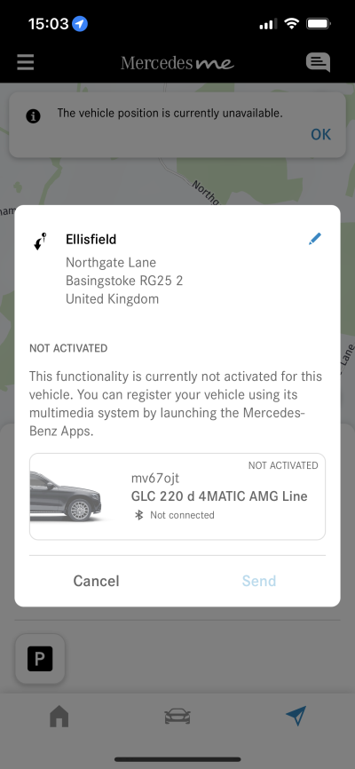

Good afternoon all,
Don't know if anyone can assist. This is an issue that affects not only myself, but also my wife (C250 Cabriolet driver). We used to be able to select destinations from with the Mercedes Me app and send them to our respective vehicles - quite useful as it was quicker than using the wheel function to type in the address. It became 'flaky' some time ago then eventually stopped working altogether. According to our local dealers, this is now a 'feature' so to speak - it just doesn't work - is this true? All the other MM functionality is working (after the odd glitch last year such as traffic info stopping working, then coming back).
I've tried to follow the advice about setting up the internet connection to my phone, that I have read somewhere on one of these pages (or perhaps elsewhere), but the system just states 'searching for iphone' then stops (my phone is all set up and working and everything else on the car/app works such as tyre pressures, odometer etc etc.). So it's all a bit odd.

That's not the issue @Germgh0st - but thanks - it won't send from the app in the first instance - see screen grab to illustrate what I am trying to/activate :)
When I try to connect this particular feature in the car, nothing happens (but everything else is OK)

Mercedes have begun withdrawing certain MM functionality for cars using 2 or 3G Sim connectivity but are keeping v quiet about it. I wonder whether your car is one of those affected? If remote services (car location, lock unlock via the app etc) are not available on MM then that will be your issue.
Looking again at your screenshot the removal of functionality by Mercedes is definitely your problem, and there is no fix as they simply withdrew the services provided without notice.
Thanks all - I thought that may be the case but wanted to double check with the MB community just in case I was being a biff. A shame really as it was a really useful function especially if planning a long trip with lots of stops.

Ah apologies, I didn't quite understand your issue. As others have said it does look like MB have turned this functionoality off in your case.
