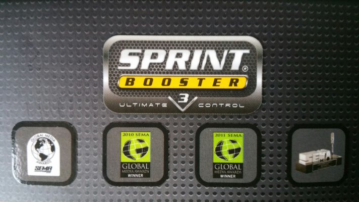

One of the best MB colours period .
Power coated 7 twin spokes too ?
Privacy glass , leather ?
Drive by wire throttle lag .

Everyone seems to suggest having a proper stage 1 map than these plug ins. I like how it can be removed easily though.

Yes Stage 1 if you fancy 700+ Nm !
Sometimes addresses the throttle lag .
The plug in I suggested is a pedal box rather than a tuning box .
