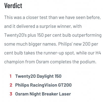

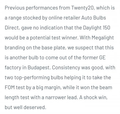

Note that these tests usually compare the brightest bulb available in their respective ranges. However, any incandescent bulb will offer a trade-off between brightness and longevity, so the blighter ones will also have the shortest service life.
I had over the years the original Osram Nightbreaker, the Nightbreaker Plus, and the Nightbreaker Ultimate, and even though life span improved with every new model, it was still significantly shorter than standard bulbs.
I finally went for Osram Nightbreaker Silver, which claim to be a decent compromise between brightness and longevity, and I wasn't disappointed - they are not as bright as the current Nightbreaker Laser series, but they are a significant improvement over the standard bulbs, and they have so far lasted 3 years which is considerably longer than any of the previous Nightbreaker bulbs lasted.
I haven't tried Philips Xtreme, but I would expect similar issues.
