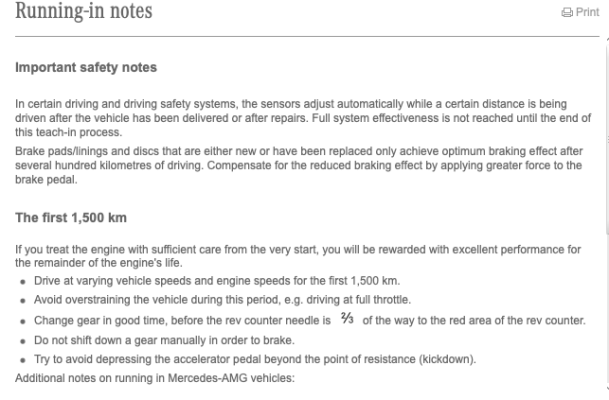

Most people do not bother to look at their owners manual but, mine says:
