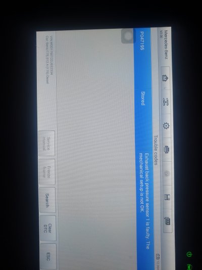

Ok , so replaced the sensor and cleared fault codes all ok for about 2 weeks and light back on again same fault code as per pictures , other 2 pictures shows statuses when engine idle ... the only thing was I replaced with a used sensor . Hope someone has experienced similar . TIA

0n further inspection i have found the black pipe is split from sensor to dpf ...
