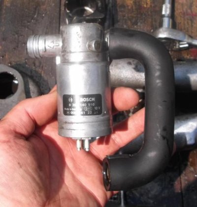

Do get the adjustment turned back to where it was to start with if you can . Can you remove the air control valve and clean it out with white spirits .You will need to remove the power plug from the rear, take out the 2 sadle screws then removing the two vacuum hoses from the rear take it out of the car .The two vacuum hoses can get hard and brittle ,but after cleaning the valve make sure hoses are all put back as you removed them . Come back after you have done this . I still think you have a bad spark plug leads or even a bad spark plug .This will make the engine shake .Look in the plug holes for water ..
@optimusprime I've googled idle air control valve to see where it is located. I should be able to to take it out and clean it. However I am not sure where exactly the power plug is located and how it looks like?

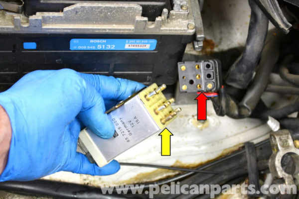

Is the power plug the over voltage relay? I googled it and found this.
So give it a shake ..What can you hear ? See the picture of ACV it has a set of pins on the end to take a push on plug thats what you remove .
@optimusprime The attachment I sent in my previous message wasn't a picture of my car and OVR (over voltage relay). It was a picture I found online to double check with you if I was on the right track. Hence, I haven't been at my car yet. Needed to know for sure if it was the OVR that I was supposed to unplug before taking out the idle air control valve (IACV). Assuming from your reply then it is the OVR that I need to unplug.
Please bear with me, I'm totally green in car parts names and synonyms, and fixing things on my own.
I'll head down soon and start working with the OVR and IACV. I'll give it a shake and let you know. 😸
AnuDa The picture is of a OVP relay over voltage protection relay this relay that you shake ,, you will find it at the back of your battery .It will be at the rear of a plastic shield or cover , you need to take the cover out to find the relay at the back of it .Look for a fuse or fuses on the top of it,check those also . Also the fuel pump relay is in there as well . While in there check contacts on the bottom of both relays .

AnuDa no need to if it is making a noise it could be the problem . It is easy to open them up and re solder the joints . But it will not last long . Try the acv valve first you will have to remove the air filter box to see it . I bet some of the hoses are toast .

Anyway, I've been at my car today and tried to take out the IACV. I wasn't able to understand where to start. I didn't find any screws to unscrew and it seemed to be fixed at its place. I've uploaded pictures on it so you could see, also check out the "toasted" hoses. Maybe you could figure out something and give me advise. In worst case I'll deliver it to a mechanic. I got contact information for an MB enthusiast through a person that work at a junk yard when I called to check for a OVP; which they didn't have. He recommended me a mechanic that would love to work on old MBs. Perhaps I've found the right mechanic for this job. I just hope it won't cost me a fortune.

The fuse is from the top of the OVP relay, if it is ok put the fuse back in place on the top of the relayput it back in place . I can see your stuck finding the IACV now you wont see or find it untill you remove the air filter box look at my picture of iacv .,.Let us know when you find the iacv . Take a picture of the parts --nuts or bolts and hoses you remove so you will know how to replace them . Do this first -- remove air filter box and find the IACV . And i bet you will find split or bad vacuum hoses .
