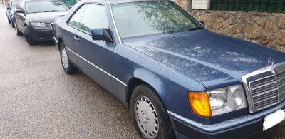

But the 124 has been growing on me lately to the point that I’ve done my homework and I’m about to buy one, now that they are still affordable.
It has to be an M103 engine that is 3000cc and 188hp and in good order. This could be it, auto, air, leather and the usual goodies but no electric roof. Less than 100k miles and good condition inside out. Good ones are getting scarce. What do you reckon?

Things to check are the EZL ignition unit and front distributor HT cap/rotor arm/leads
Body wise Rear sills /jacking points/ rearsubframe front body mounts for corrosion failure
Thanks Graeme
However, from what i gathered, the ignition module is more of a problem for 24 valves engines, the 300CE 12v EZL did not suffer as much and is a lot cheaper to buy
Just my personal choice , but I wouldn't buy one without a sunroof .
I've made that mistake a couple of times , bought an otherwise nice car in haste then always regretted it .
especially with a pillar less coupe , there's nothing nicer than having all the windows down and the roof open on a nice day . Air con keeps you cool , but it isn't the same .
I do appreciate these cars are getting rarer , but I'd hold off .
I'd also suggest , having had multiple examples of both , that the 24V engine is much nicer - despite the extra camshaft it is actually a smoother engine than the single cam , both of course so much smoother than the trashy M110 , which I've also had several of ...
A well looked after 300CE-24 in either Nautic Blue or Almandine Red , with mushroom leather , burr walnut , air , sunroof and cruise would be my holy grail .
Oh , while I've never had issues with EZL units on any of my cars ( but did with its predecessor on my W114 280E ) , the dizzy caps on the M103 and M104 300-24 engines do need to be changed roughly every 30,000 miles , always put a genuine Bosch one in as I've found the cheaper Bremi ones some places will sell you can go bad in as little as 10,000 miles .
I always used to make my own ignition leads up ( the dealers will sell you the ends ; sometimes you can reuse them ) from a drum of aircraft quality cable I was given years ago , and once done , never had any problems .
