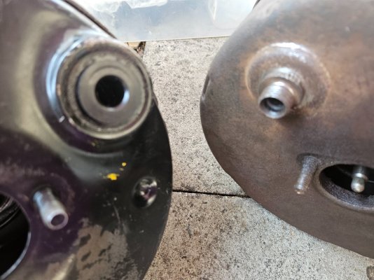

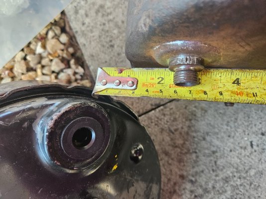

The used servo I bought is also known as a T52 servo (I think). My issue is with the connection of the vacuum pipe.
On my original servo, it has a plastic push-fit (see picture), and the T52 servo is a different setup (metal) with threads (see picture).
Is there a part number for this fitting?

No idea of the merc part nunber, but a hydraulic hose place will sell you a barbed tail that screws onto that. Then it's just a case of heating the plastic pipe and forcing it over it.
