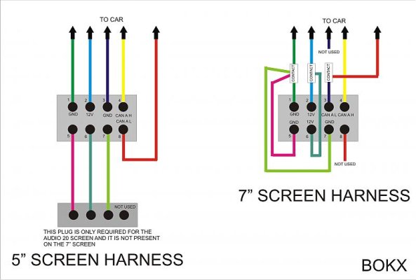

So my problem is when I put it all together my screen doesn't open and my new comand unit buttons don't work it's like he doesn't turn on! But when I use my 5 screen it shows 1/4 screen and GPS works and the radio works, you can around and change language and do all the stuff but the new command unit buttons still don't work, and can't turn the unit off or on, I can only use the Push-Button Switch Audio/Comand Control Panel which is middle between seats.
yes, I rewired the screen from this diagram, and all fuses are okay.
