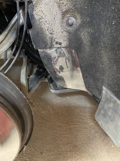

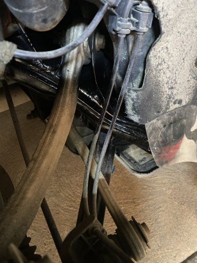

Have a look on YouTube, there’s a few on there, also, when you do get the rear wheels off, scrape out as much crud from the open ends, spray in a load of rust converter, then spray paint in there, I made some extensions for the wheel arch liners, to cover the open ends of the frame, seems to be working a treat, I used thick transparent film. IMG_3258.jpegIMG_3257.jpeg
