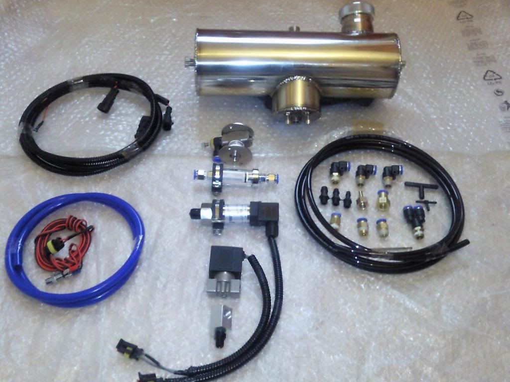

I use to make this kit when I was racing with my Rx7 completely mechanical no pump. It would rely on the turbo to pressurise a tank of water and meth mix.
this kit would do everything that normal water injection would do the only difference was that it was a pre turbo kit so the nozzle would go before the turbo, on the filter which had the effect of extending the compressor map which meant you could run a small turbo that would make a little more power. Now that I have cls 55, I'm playing with the idea of building one to go pre supercharger as it could help cool the charge cooler which will heat soak normally from the engine. I'm planning on modifying my car to 550-600 so just doing the research now but I'm sure my kit can be used on these cars too. Will do some testing on mine and see how it goes.
That's an interesting idea. Was the pressure controlled by a regulator?
Why not just run a mix with a boost switch with an electric pump? Would that not do the same job?
