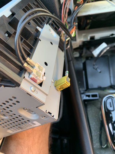

Hi , new to the forum and require a little help please, I have just swapped out my factory MF2860 (a203 870 34 94) to a Sony XAV-AX1000 , I have used the connect 2 wiring harness and have the steering wheel controls and rear camera working but I can’t get the tuner to work ? On the back of the MF2860 there are two fakra sockets - a double white Fakra and a single yellow Fakra - I assumed rightly or wrongly the double white would be for the antenna so purchased a cable and connected it to the new head unit but still it doesn’t tune. ?? Any ideas or does anybody know what the white and yellow ports are used for ?

You need a power-insert adapter (phantom feed adapter) - the Mercedes antenna needs power fed up through the coax to provide the antenna amplifier with power
Yellow is bluetooth antenna, Double while is 2x FM/Am antenna -
The blue wire then connects to the blue antenna / amplifier output on the new stereo.
